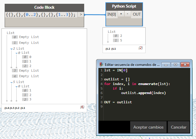

How to get list of indices?
I have long list with sub-list. All I need is new list of indices for all none empty sublists…
so in this case result would be list {45} as this is only none empty sub-list…
For some reason using List.AllIndicesOf doesn’t work, but you could also do this:

Another solution:

Maybe this helps:
You need the list lenght = len(i) as Salvatore shows in his code. You can also simply use if i.
Do we know why List.AllIndicesOf does not work ?
I had this problem recently & thought I was doing something wrong
Andrew
Not sure why your are trying to modify the “if” part of the code to achieve the same result.
“i” in the code is a list. if you want to extract all lists that are not empty you can use the code I suggested which check is the length of the list is not equal to 0. Or as @Organon suggested just write “if i” (a list which is not empty is by definition True).
But i>0 won’t work.
In the example below 1& 2 do exactly the same thing. 3 gives you how many items are in the each list. (I’m just shortened the code using list comprehension this time).
I hope this helps.
