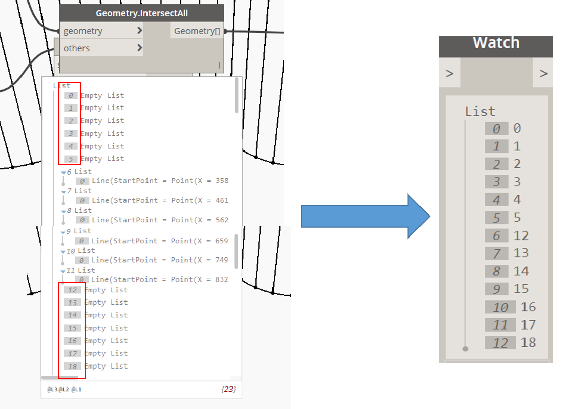

I’m struggling with the list now. I’m wondering if I can get the index of Empty List from a list.
Kindly take a look at the picture
Anyone has solutions ? thanks

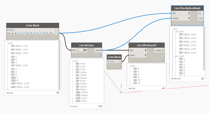

Use List.IsEmpty with Longest lacing or list levels.
thank you Nick for swift response,
now I’ve got there, what to do next ?

You could also use List.FilterByBoolMask, using List.isEmpty as Mask
@truongbaolam0209 attach a List.AllIndicesOf node to List.IsEmpty with the boolean true as the item input
it is not working, could you pls elaborate more ? thanks
@awilliams
i can’t get it, could you pls elaborate more ? thanks
Assuming you want the indices so that you can then get elements at those same indices, you can just use FilterByBoolMask to filter your elements based on the true/false values you get.
