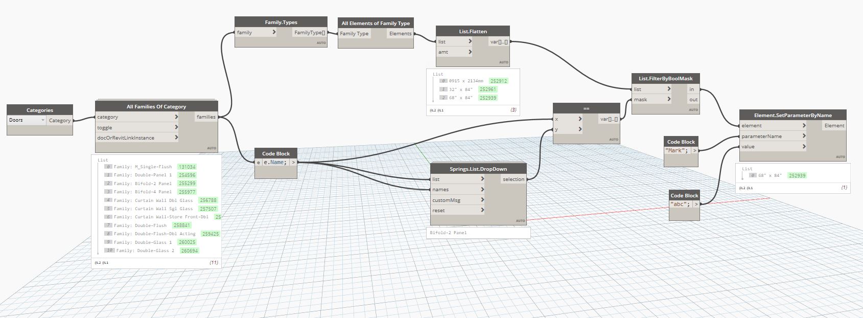

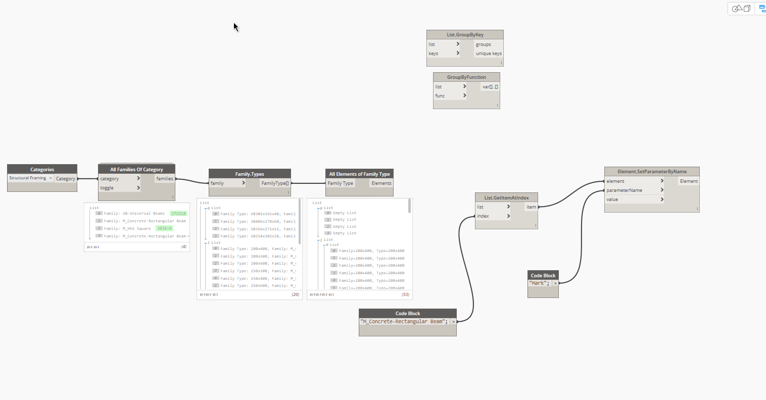

I have a list, i want to make filter elements by the option name family, but I have not yet.
Everyone help me.
Use Name node to get the Names,
Use == node to check if the name is equal to your ‘concrete-rectu…’ name
Use filter.byboolmask to filter the types.
Something like that?
You can also reduce your number of nodes by using All Elements of Category instead of getting the category > families > types > elements of type. This will give you a single list as well so you won’t have to worry about list structure.

Careful here, @robert12546358. All Families of Category returns all loaded families where All Elements of Family Type returns all placed instances, so your lists don’t actually line up between families and elements.
