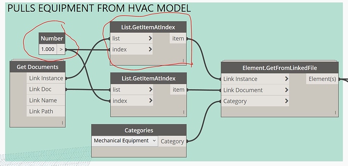

Mine should work for your coordinate issue. This one pulls the XYZ coordinates from the linked mechanical model and then drives the FamilyInstance.ByPoint node.

Thanks I got your method working it fixes my issue I just have one problem, I’m not sure what link document does in the “Element.GetFromLinkedFile” node I had to iterate through some values which was ultimately different from the link instance value before I got the right one to get the right equipment to come through do you know a way I could get the right value for the link document field without having to iterate through some values? For example the value for my link instance was 4 and the one I needed for the link document was 7.
You have to go to Manage Links and see what line item the linked file is then plug that into the node. I don’t think this can be automated because it has to point to a specific linked model and you have to tell it which one you want.
