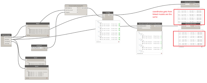

I try to make a dynamo script to get the actual coordinates of plumbing fixtures (drains) found in a linked models related to the host model coordinates, but the coordinates that got from drains in linked models are the coordinates of these elements in the linked model not in the host model .
I need the actual coordinates in host model to copy these elements in host model, here under a graph that show what I mean ., Any Ideas

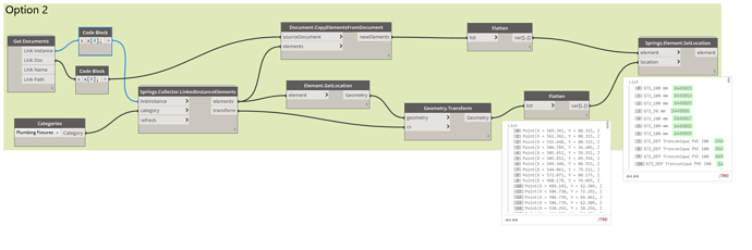

You probably need to use the coordinate transform of the document to copy your elements in the good location.
“Springs.Doc.CopyFromLinkInstance” node use the transformation of the link to copy the elements.
Thanks alot , i will try it, but i have some questions,
This node comes from spring package ??
Is this node works for multiple links instances??
And you can copy elements and change their location afterwards :
Yes it’s from Springs package. Try with lacing on longest on the node.
Thanks a lot Genius Alban i will try it then send u feedback thanks again
