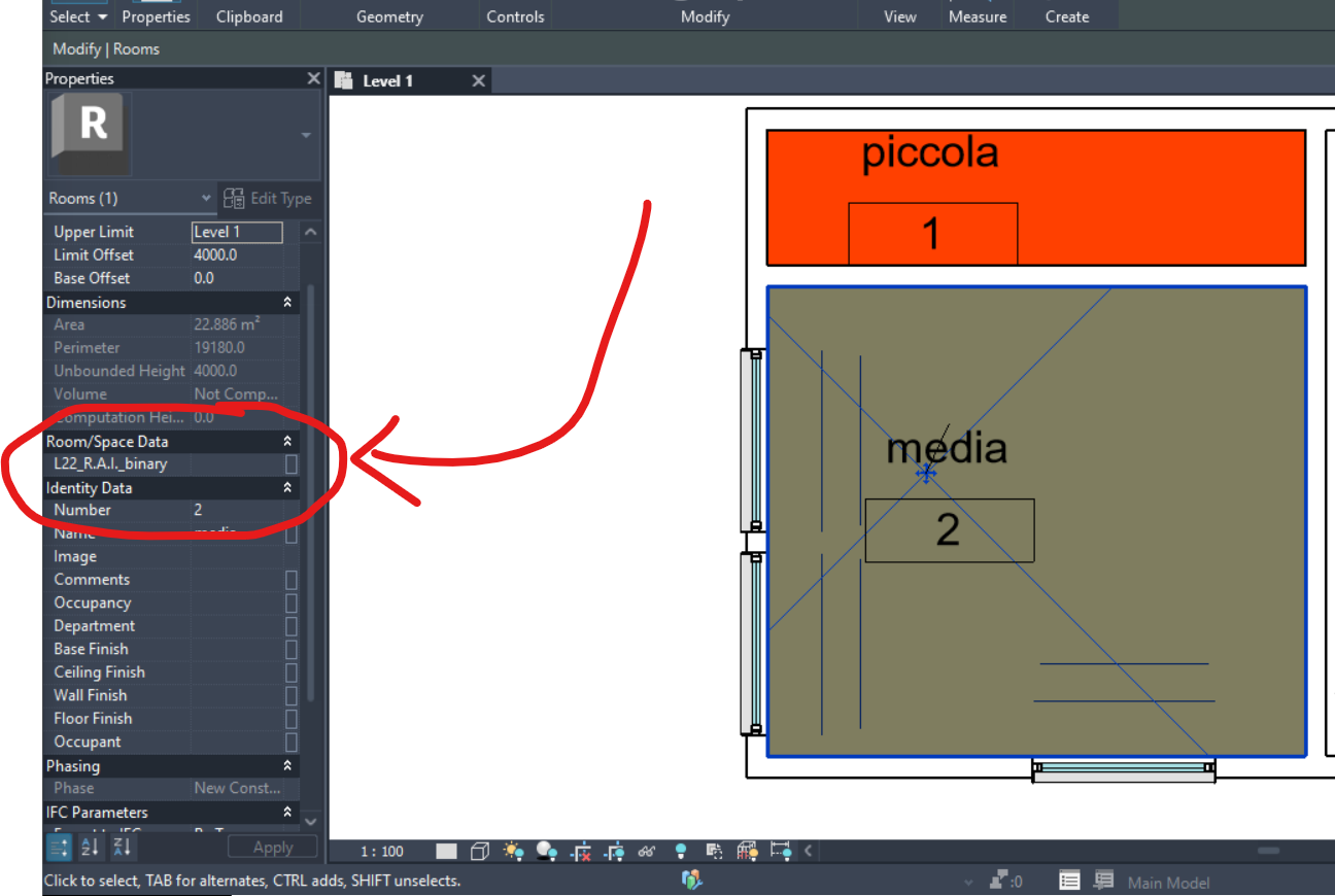

i cant find a way to create and assign a new shared parameter to the rooms and than fill it out whit a list of values that i alrady have, all whitout using any package/add-on.

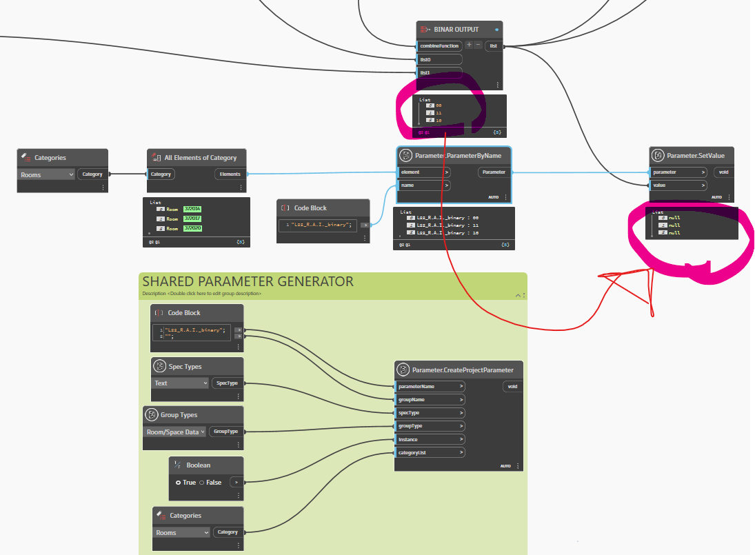

for the moment iâm here, but no idea why the values from the list dosent show up in the room propriertis

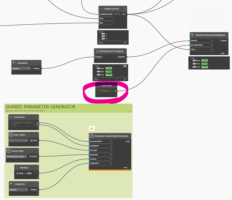

Instead of Parameter.ParameterByName try an Element.SetParameterValueByName.
Also before you pass the name to that node you should confirm the parameter exists by using the resulting value from a WaitFor method, configured to pass the parameter name after the parameter is created. Alternatively you could run this as two graphs - one to make the parameter and one to set the value(s).

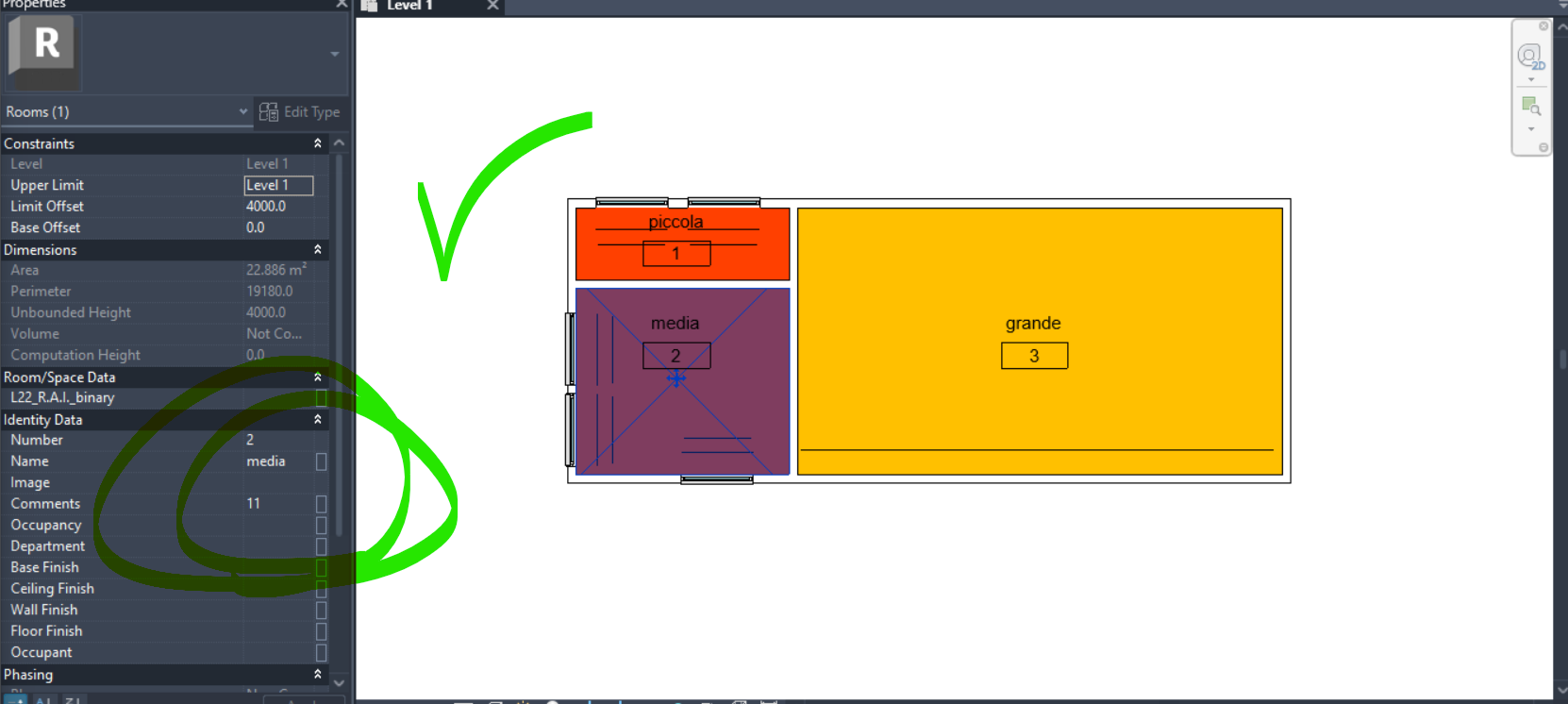

actually it perfectly works if i put in the parmaetr name a sistem parameter like âCommentsâ but dosent work whit my shared parameterâŚ
Not while - WaitFor. There are a lot of packages with this node in it, and several discussions k. The forum for it. Basically put this in a codeblock: [passThrough, waitFor][0];. This will ensure the output to the âWaitForâ input is complete before the âpassThroughâ value is fed to the next node.
You are seeing âroomâ from the set parameter node as the roomâs are having their parameter values set. If you think of it this way, when you grab the room element in the Revit UI and set the parameter value manually you are operating at the room not the parameter element (which is what you were doing before).

i have tried to put the âcommentsâ name for parameters and works perfectly, but dosent whit my shared parameter, why??? ![]()
thank you @jacob.small, solution found!
