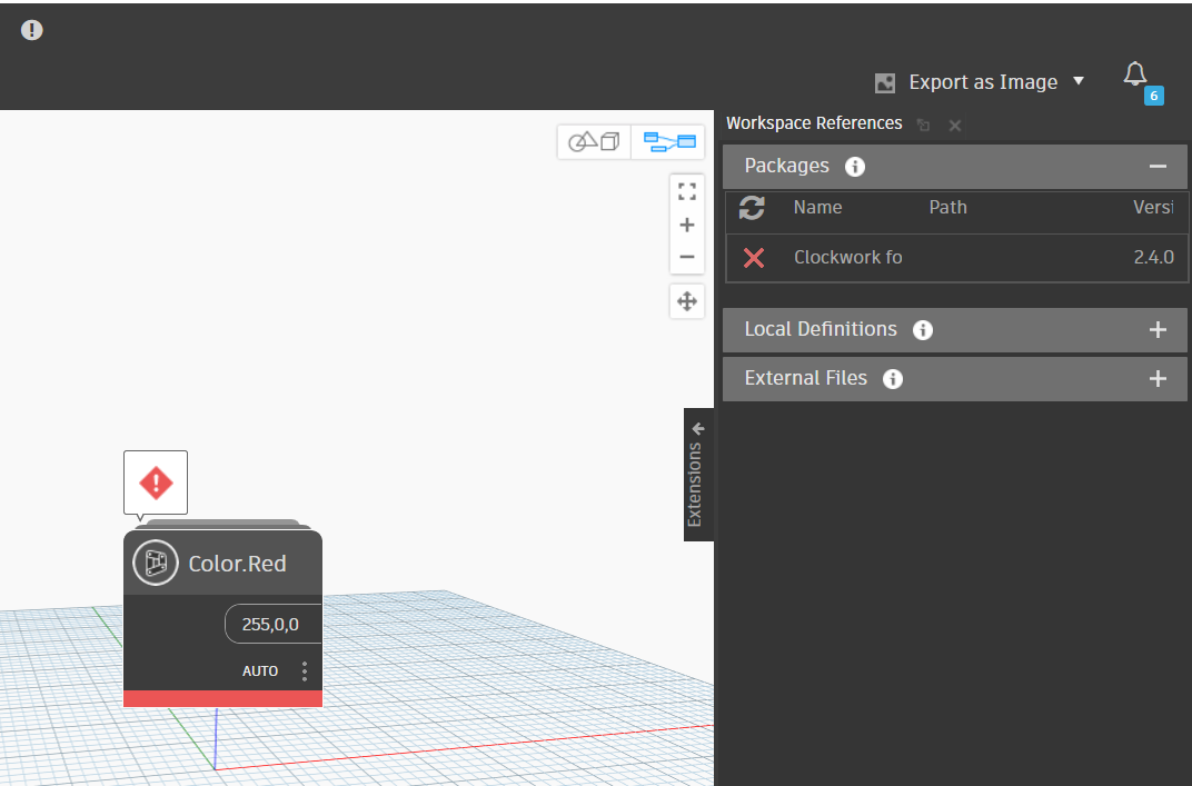

Hi @enkus ,
You should have an openable dialog box / tab on the right called the “Workspace References”. From here you can see which Dynamo Packages & Versions are used in the script. This should automatically open for you if you are missing one or more / have a different version than one or more of the packages used.

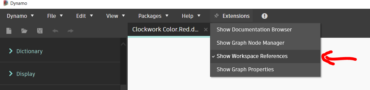

You should be able to open this through here:

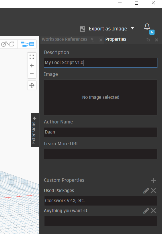

You could:
  1. Add a text note (ctrl+w) and put your used packages in there. Together with maybe some other metadata like the author, data and a description of the script.
  2. Using the built in “Graph Properties” (added in 2.13). Also openable from the “extensions” ribbon button just below the “Workspace References”. This will open the following tab:
