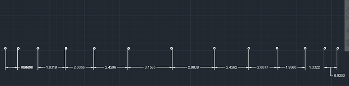

How to create different segment length points?

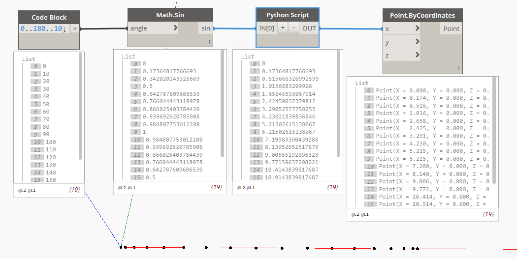

actullay i try something but its not working.

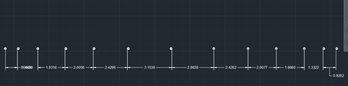

i want to like below images
Are there any pattern in your num list?
If the sequence is symmetric, you could include a segment of negative numbers? you could set that distance in a new list.
In your first image you’re creating all the points based off the origin. You’re just listing the values in terms of displacement, not in terms of length along a curve.
You need to build your points based off previous locations by using the total displacement from the origin. Basically, you need to sum up all previous values.
dataEnteringNode = IN
nums = IN[0]
out = []
prev = 0
for num in nums:
	sum = prev + num
	out.append(sum)
	prev = sum
OUT = out
@Nick_Boyts very thanks its working…yes you are right sum of previous num is good…and thanks once again for you valuable time to spend and paste the script.
