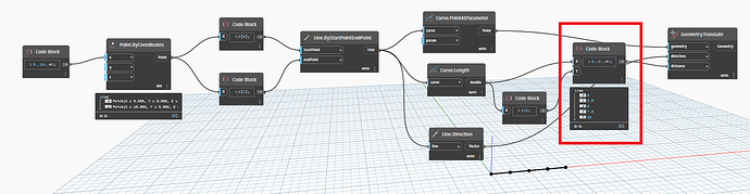

Hello everyone,
here in the graph the geometry is maintaining distance 2.5 mtrs each other. but i want to get the intervals of 0..2..2.5..4.5..5..7… etc. Basically first point 2mts and second point 0.5 mtrs intervals and continue the sequence.is it possible, if anybody knows please help me. thanks for your support.

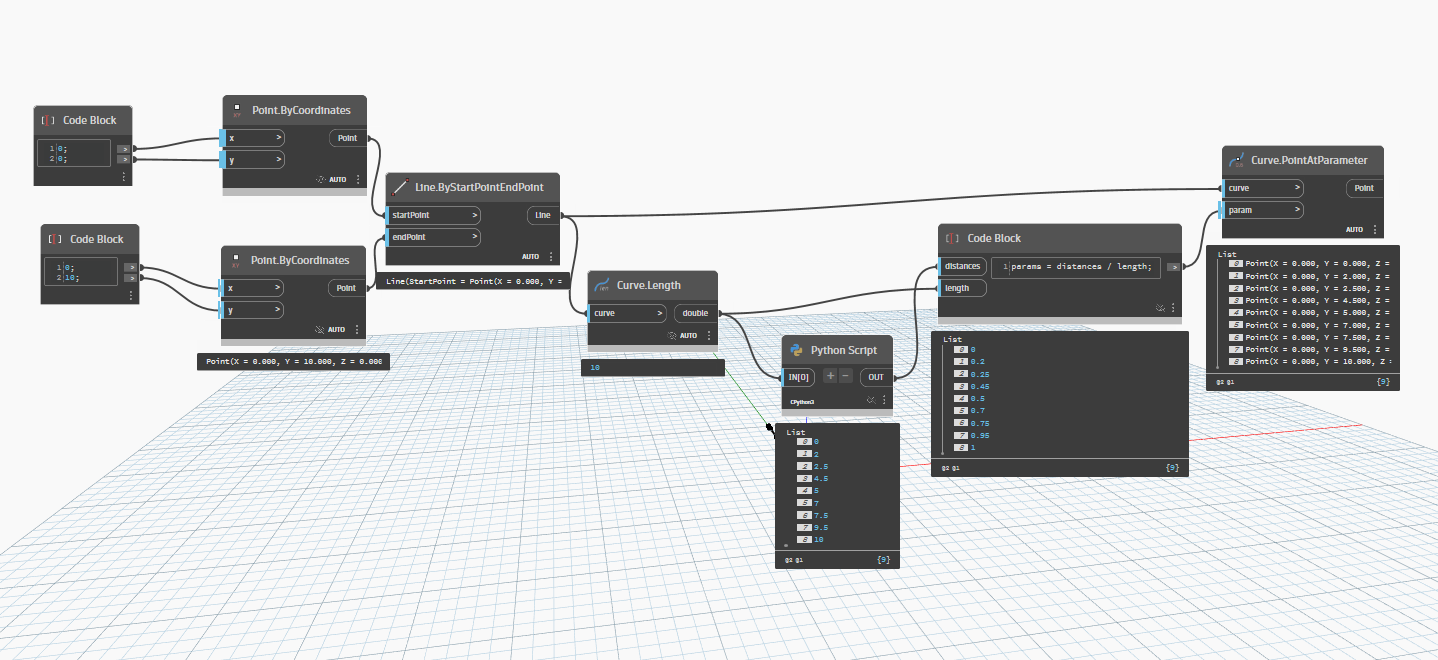

you can try like this: then use this point to translat.
test.dyn (44.9 KB)

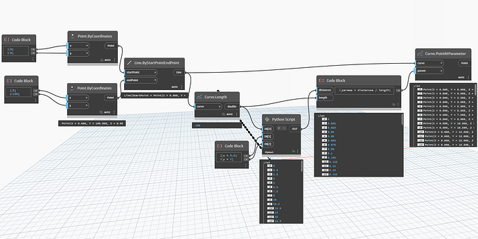

Thank you vijay. a small request , can you please add input values as x and y instead 0.5 and 2. because i am totally blind on python script. i tried but it didnt work. but it is solution for what i asked. please help me in this regards. thank you very much.
This is just a variation of a cumulative sum, where you’re specifying alternating step values.
Here you go,
test.dyn (47.1 KB)
