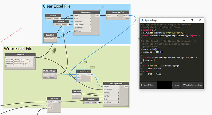

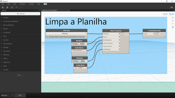

i found the solution by my self, here it is.
I just created a “little” dataFilter for my Path Input. This way it can only start input when the sheet was cleaned :slight_smile:
