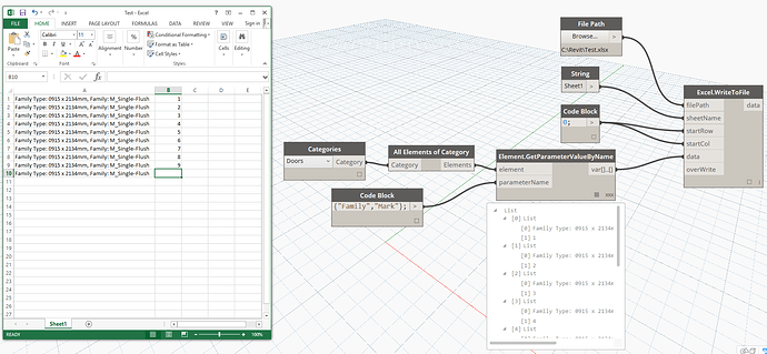

Hi Fiala,
Yes it is possible see below example of door.
This is before thee are 10 doors from revit to excel:

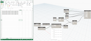

And this is after i deleted 6 doors from revit to excel how to clean excel data.
Note: Above examples are shown is same excel file.
Good Luck!
Hi Kulkul,
Can you show larger screenshots for clearer Dynamo scripts?
Thank you.
Regards,
Chin
Dear Kulkul,
Thank you very much for your quick response!
Appreciate it very much.
