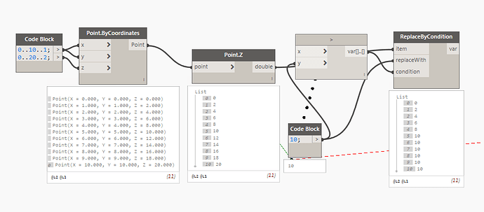

i have a list with points. I want to change the z value of the points when its less then -300 to -300. So is the value is -600 it should be -300.
is there a smart way to do this?
Dynamo RemapRange node
Here, for you to get more understanding …
Eg, Z values greater than 10 , i want 10.

If you’re not afraid of some design scripting you can do something like this:
What about the ReplaceByCondition node?
Afraid? haha yes a little bit… but i like to learn! This is exactly what i am looking for. Thanks a lot
