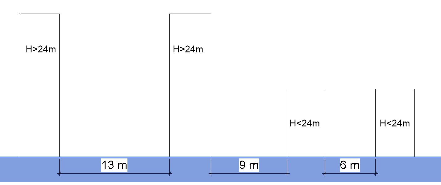

Hello, everyone, I am from China.As an architect, I often meet the situation to arrange the buildings layout on the plot plan based on the fire safety national code. see diagram below.
the minimum distance is 6m between the buildings height no more than 24m.
the minimum distance is 13m between the buildings height more than 24m.
the minimum distance is 9m between one buildings height more than 24m and another is no more than 24m.
