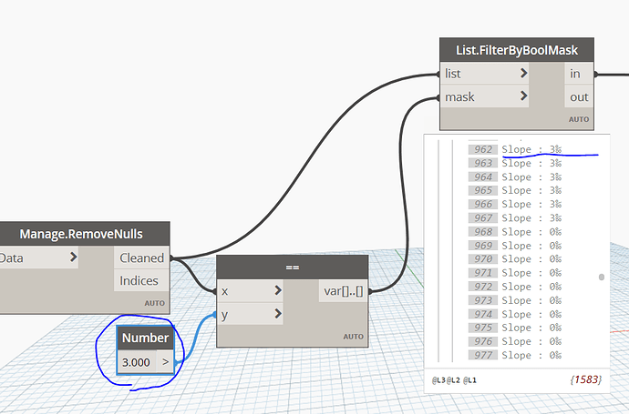

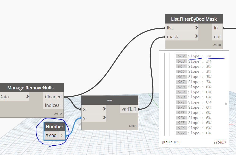

Hello Arun_Prakash try a string variable instead of a number and write Slope : 3%.
Also take care to ensure that by cleaning null values you may have reduced the number of items in the filter list - otherwise you’ll error out or get a bad result on the filter by bool mask.
