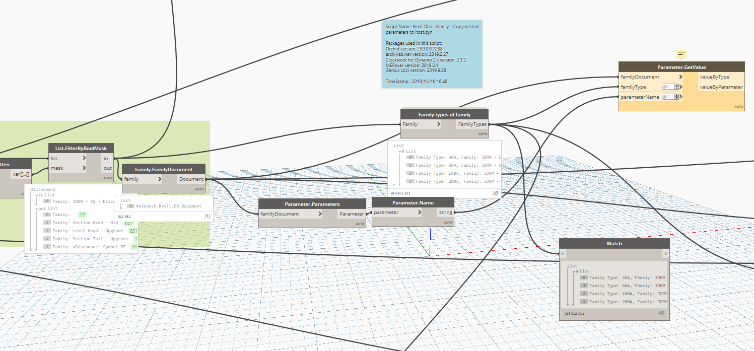

I feel like half the time when I try to get the correct input for any node I pick the wrong node that provides the Autodesk.Revit.DB.xxx version when it wants just xxx or vice versa. Is there a way to convert easily between these two forms? Here is an example I’ve ran into today with Document and FamilyType:
AutodeskRevitDBxxx01
Likely this is a namespace collision with a custom node. Can you show what the nodes running into this are, making sure to label the package they’re from if they are custom nodes (Monocle view extension helps)?

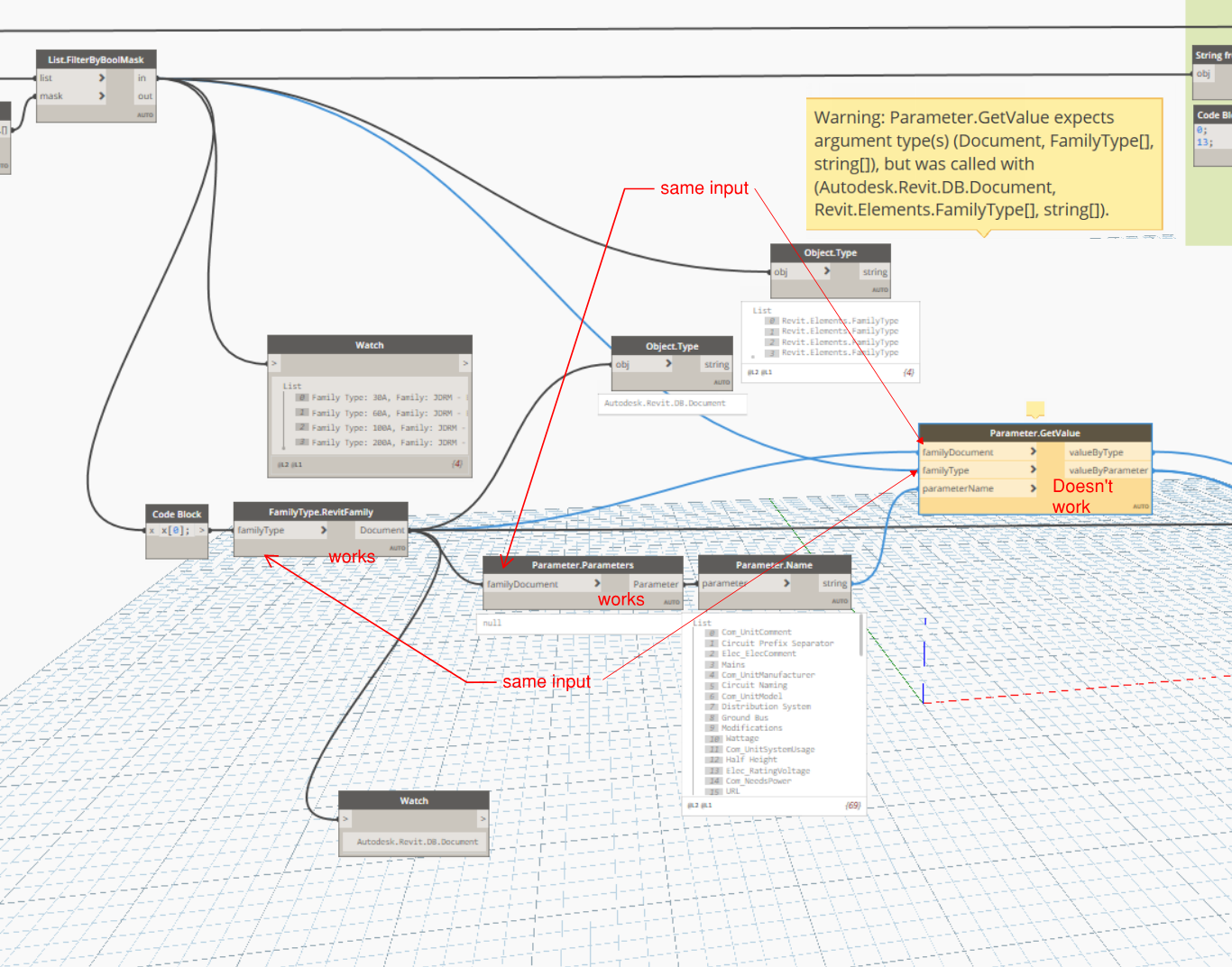

Orchid’s document classes frequently clashed this way for me (File.FromPath vs File From Path; Document.Current vs Document Current). Been awhile since I’ve seen this though. Micellany’s Point is another one.
You were right about it being an orchid node. Sorry for the mess I’m trying a lot of things out in the script so it isn’t cleaned up yet.
Once you go into Orchid you kinda have to stay there - mixing Orchid and non-Orchid nodes tends to not work out well. The Orchid GitHub might be a better place to ask as @erfajo isn’t really active in the forums anymore: GitHub - erfajo/OrchidForDynamo: This repository contains the content of the Orchid package for Dynamo.

I tried again with a fresh script. All built-in dynamo or Orchid. Still doesn’t work. The same input seem to work with other nodes from Orchid that look like they want the same thing.
Can you post a DYN with just those nodes please?
Github response
I got a response on the Github. I’m still trying to figure out based on his sample scripts. Apparently I shouldn’t say “script” but I think this post has cemented my use of it for all time.
