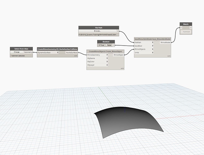

Hi everyone,
I’m running:
Alias 2019
Dynamo 2.0.0.4354
Rhino 5 SR14 64-bit
Grasshopper 0.9.0076
I am trying to get a streamlined workflow between Alias and Grasshopper up and running.
Grasshopper to Alias works fine. But I’m struggling with Alias to Grasshopper.
Rhynamo doesn’t seam to export a Rhino file. Maybe someone can tell me what I’m doing wrong.
Thanks a lot
You might need to add some information for the Rhynamo nodes. I don’t have the package installed right now, but it looks like there aren’t default values for Objname, ObjColor, ObjLayer, and Units, so you’d need to wire them up.
