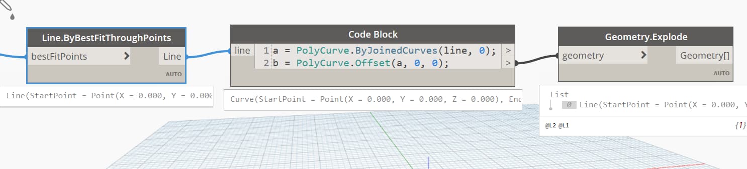

How convert the line to a curve
I want to ask a small question.
I got several unconnected lines.
But I convert the line to curve.
I think all the nodes that apply to curves can apply to lines.
In your example :
  • PolyCurves.Curves node is not working because it is expecting a PolyCurve, not a curve/line.
  • Element.Curves is expecting a Revit Element.
  • CurveElement.Curve is also expecting a Revit element.
PolyCurve.ByJoinedCurves should be working, but i guess there is a problem with your lines. The error should be indicated by the node.
@mellouze
It show Curve join produced more than one WIRE in PolyCurve
Your lines do not form a closed curve then.
@mellouze
If it is not closed, is there a way to convert it?
use point.project
