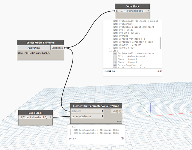

Can we see your graph? It should be possible by retrieving the parameter value.

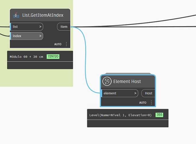

The Element Host node from the Genius Loci package should work.

Hi Andreas,
It’s not the same.
You obtain a string value with the GetParameter node and not an element.
I tried it but it just retrieves me the level. Maybe is the way the family was created
