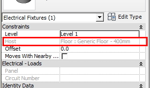

I know that there are nodes that read the host for elements, but they only work when the family is host type
I mean here to read the host id in case the family is eq generic model not hosted but have work plane object

there are two reasons why I think that in both cases the host should be specified:
when you change the floor level, both elements follow it - they are pinned to it
in the properties as in the screenshot above, there is the name “Host” where the name of the floor type is given - so I guess that the ID number of this floor is also stored somewhere there.
It is not important for me whether this floor is called host or otherwise
I am interested in whether there is any node or API procedure that will allow me to read this information
