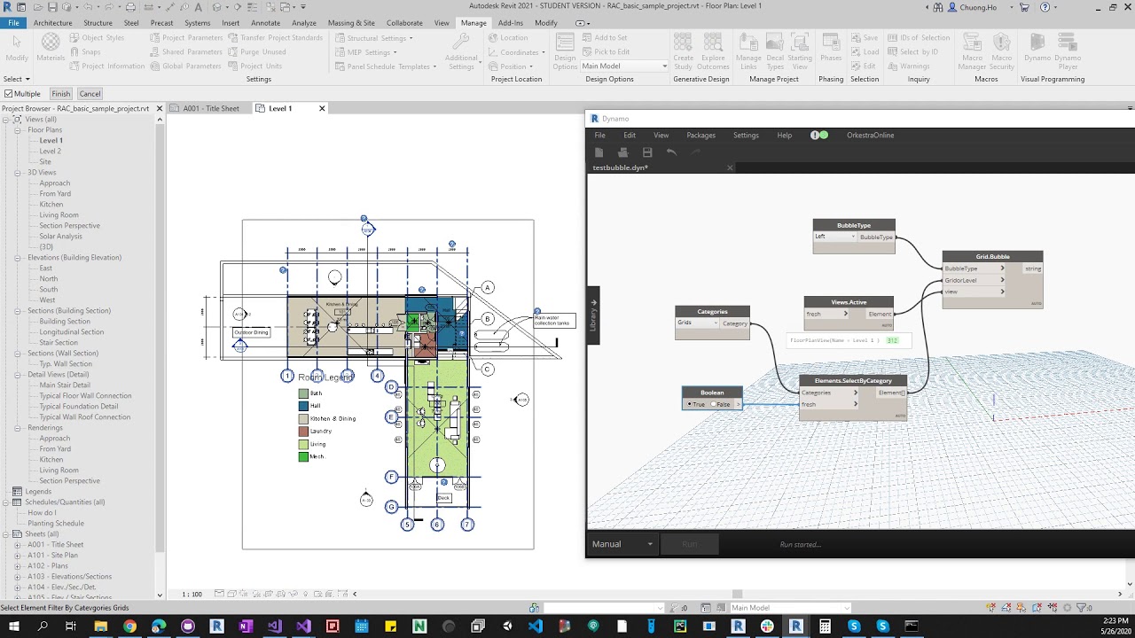

I have a solution simple than for user dynamo

Not a problem i ended up dividing the script up and using it via dynamo player works well and people dont get scared off as much.

thanks for the great script! I modified it a bit to turn on/off all bubbles. also since its in 2.6 the built in functionality of the current view doesn’t require the run boolean… so no packages, figured i should share :slight_smile:
Views_ToggleLevelBubbles_2.6.dyn (17.4 KB)
Is the BubbleType node just a string? I couldn’t find it in the DynaMEP package.
