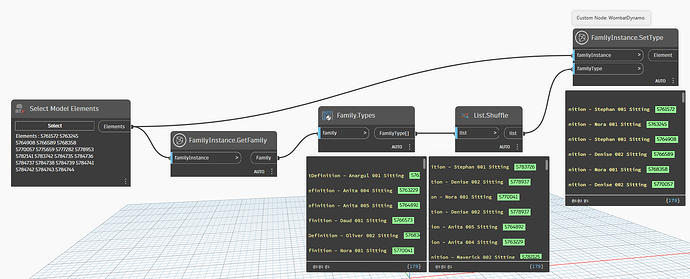

Hi All,
I’m having some difficulty finishing off my graph to randomize placed family types.
I figured I have to extract the type ID values of each into lists and somehow combine/randomize them before changing the family type.
Any help would be greatly appreciated.

Thanks Mostafa, that works well - It’s a more elegant solution than my attempt.
How would I modify the graph to repeat the randomize process each time I select run?
Cheers,
Mark
Thats’s a good question … Unfortunately I don’t have a better response than copy paste the List.RandomElements
Try adding the “ForceChildrensEval” node from the “Prorubim DS Common Kit” package:

Thanks to both of you for your responses.
Dimitar, that _ForceChildrensEva_l node worked a treat!
Cheers,
Mark
Here is my new version for Revit 2023.1:
