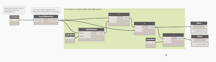

As an easier alternative to this, you can try adding ProruBim’s ForceEvaluation node to one of your initial inputs at the start of your script.

Well if you post your graph, we might be able to figure out why it’s not working.
Here’s what you should expect to see:
And here’s an older example:
Try adding the “ForceChildrensEval” node from the “Prorubim DS Common Kit” package:

this what I am looking to do I am using Data-shapes package, multipleinput node as you see in the picture, so the idea that after put the input and hit the button the graph will execute then show the form again rdy for the next inputs. because I don’t know if the ForceEvaluation node will do the required , wt you think ?. athank you
