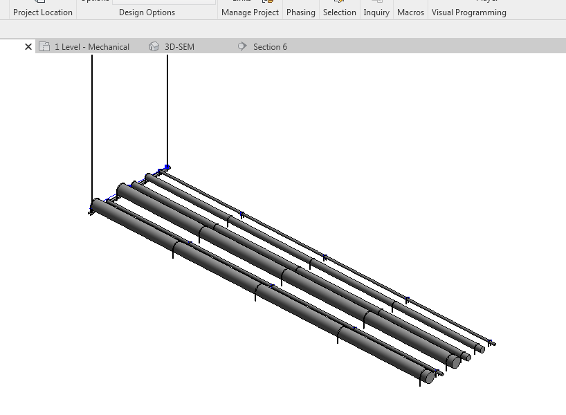

here are the files
PipeHangerUBolt.rfa (316 KB)
PipeSupportConfigurator final.dyn (254.3 KB)
Steelbar.rfa (316 KB)
ThreadedRod.rfa (300 KB)
and here is what i achive for now i have distribute the u-bolt but cannot get to distribute the steel bar & threded rod if you could help me i will also give the conduit version of this
