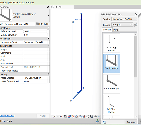

Hello, I have multiple points and i need to place a fabrication hanger to those points. I couldn’t find any nodes to convert point to fabrication element.
Also need to change the size of the hanger too. But when i check the parameters in revit properties no option shown there.
Anybody tell me how can i do these in Dynamo. (I am a beginner in dynamo)

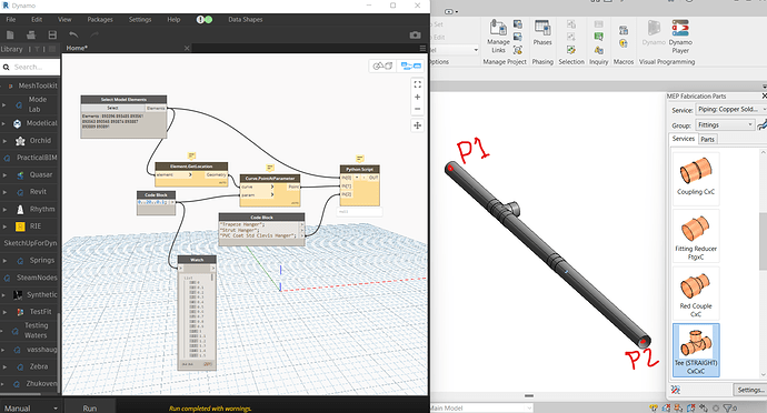

I am not familiar with any programing language. But I have copied this example code in Dynamo and run the script as you shown in the image.
In my understanding this code will place hanger at (given input) distance, and it will work with only one element at a time. Correct me if I am wrong.
When I connect multiple pipes, this script shows some warnings(see the attached image).
Actually my requirement is that I need to place hangers at a specific distance in a pipe/duct run (a pipe run may be contain multiple pipes/fittings/couplings/solder joints/welded joints etc).
Is there any way to update this script for placing the hangers at a distance of 5’-0" by selecting a long pipe run and considering start and end points (P1 & P2) as marked in the image.

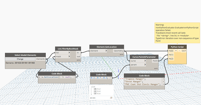

When I to run the new script, its showing some waring in the python script. Am I doing anything wrong?
Please se the attached script.
Hanger-Python.dyn (16.5 KB)
Set the lacing of the Curve.PointAtParameter node to “Cross”
I have tried the lacing already. Still it shows warning in python code. Also It would be better if we can provide hanger distance in code block as input. I mean, if the pipes total length is 10’ , the hangers should be placed at given input distance. Instead of providing the total number and steps in code block[0.2…0.7…0.2] a single input (hanger distance) would be work better.
Sorry to disturb you again.
Untitled
You have an error in your graph, show the graph in this post
