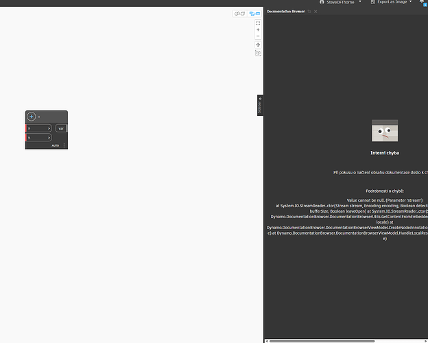

Help documentation in Dynamo for Revit 2026.2 appears to be in a different language
Help documentation in Dynamo for Revit 2026.2 appears to be in a different language. Is this just me?

I have no problems anywhere else. It looks like it’s isn’t working even if I could read it though…

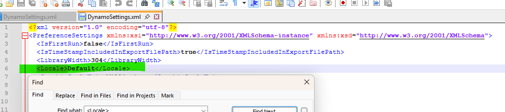

@SteveDFT Could you check your DynamoSettings.xml living in your version of C:\Users\amours\AppData\Roaming\Dynamo\Dynamo Revit\3.4

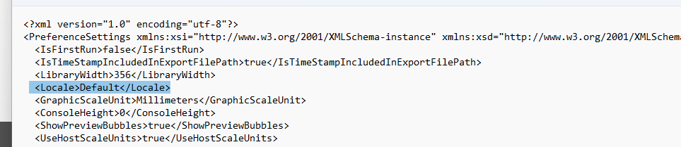

Inside this file (You can look at using NotePad or similar) you will see a locale flag… does this say Default, or otherwise?
This maps to the Preferences modal:
Setting it to English in the Dynamo settings instead of Default has fixed it for me

Nope. But if it is isolated to this install / my machine, setting to English is all good as a workaround.
