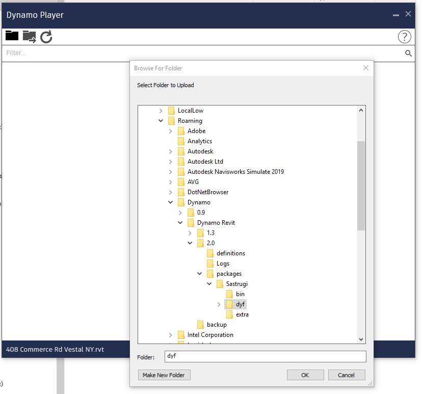

I updated Dynamo 1.3.3 to 2.0 and restarted Revit. When I started it back up, to run Dynamo, it asked me what version, and I chose 2.0. I installed the package Sastrugi Package Version 0.1.4, and when I updated the directory to those scripts, nothing is appearing after I refresh.
1: I’m and new to Dynamo so I’m directing it to AppData\Roaming\Dynamo\Dynamo Revit\2.0\packages
that didn’t work so I redirected it to AppData\Roaming\Dynamo\Dynamo Revit\2.0\packages\Sastrugi
Then finally to AppData\Roaming\Dynamo\Dynamo Revit\2.0\packages\Sastrugi\dyf
With no success.

The directory in question only has .dyf files in it. That extension indicates a custom node for use in a Dynamo graph, not a Dynamo graph which has the extension .dyn. It looks as if you’re trying to access these custom nodes via Dynamo Player, which works only on dyn files.
  1. To confirm, open Dynamo (not Dynamo Player), Create a new graph.
  2. Place a few nodes so it performs an action.
  3. Save the graph as ‘test.dyn’ to a common location (ie: my documents or your desktop).
  4. Close Dynamo and launch Dynamo Player.
  5. Path Dynamo Player to the directory where you saved the .dyn file.
