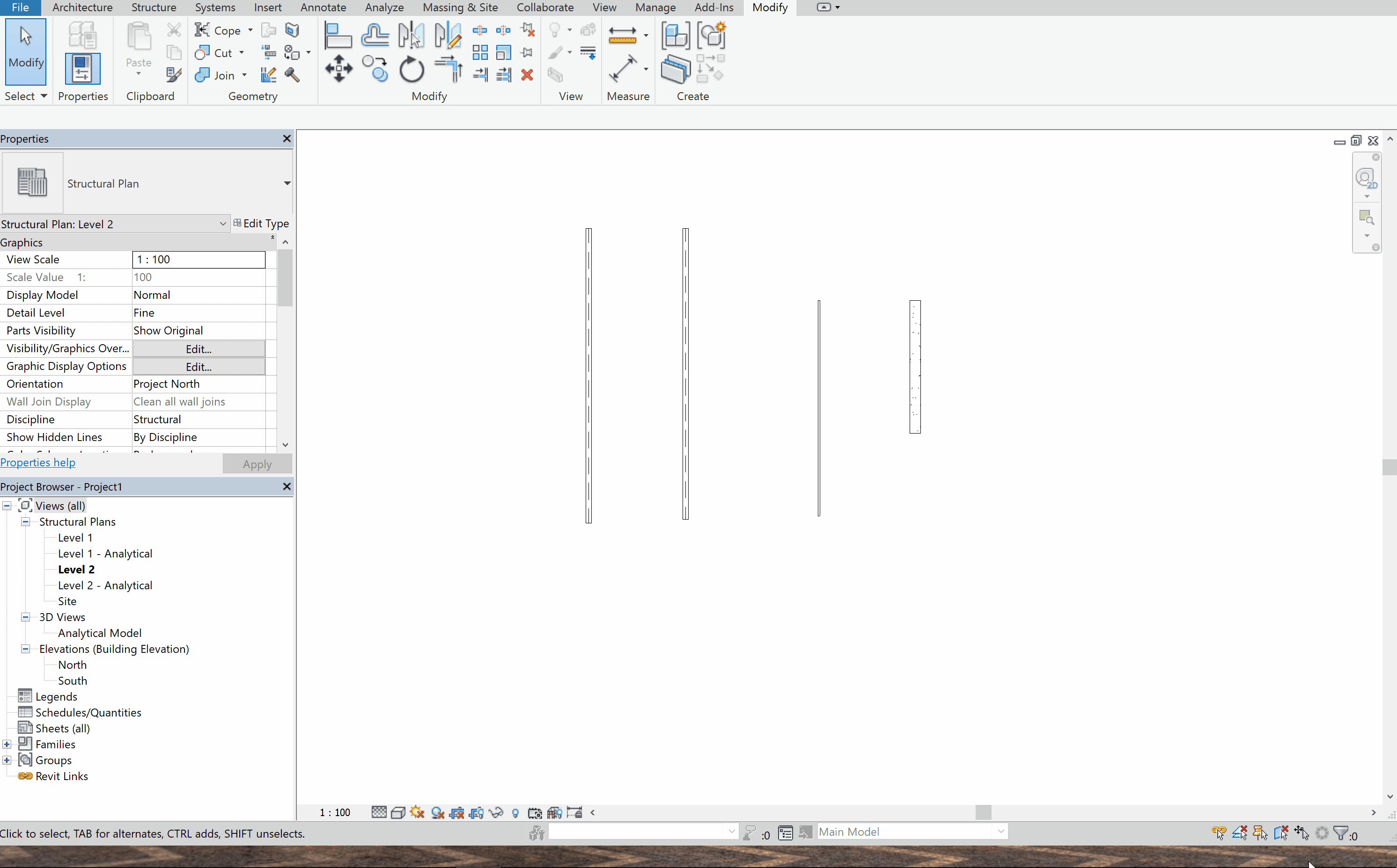

Good day. Hopefully you can help me. I would like to create a graph that will result similar to the image below wherein all structural framings with the same length will be grouped and count the instances.
Right now I am stuck in here:
Regards
Jay
