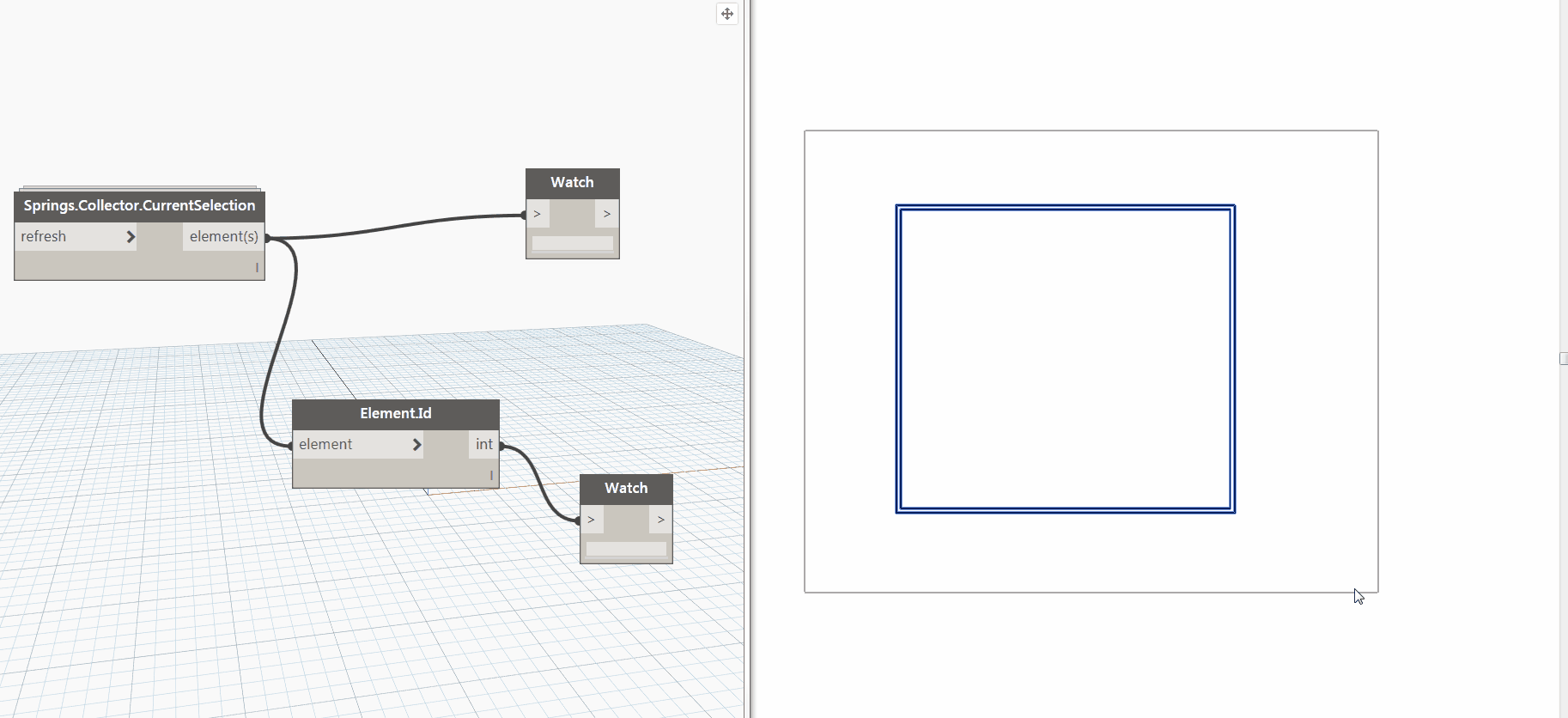

@bogdan.petrescu63URX you need to change the true/false value to refresh the current selection.

It’s not down to luck, I use this node a lot and it works every time.
You need to put a boolean in and toggle between true/false each time you want to update the selection.
Capture
The value of true or false is not important the node will work with both. Changing the value only refreshes the list.
If you don’t change the boolean it will retain the previous information.
If you change it to false and run it again it will update and vice versa.
ok so i want it to change every time by selecting new elements and running the script, so i should leave it on true.
it doesn’t work, sometimes it clings to the previous selection.
if i toggle between true/false in the bool variable nothing happens.
i am using manual execution mode. should i be using automatic?
can you please explain again maybe in different words how to make sure the list is updated to the current selection every time?
thank you!
  • i just enabled automatic mode and toggeling between true/false clears the list!!!
OH MY GOD thank you so much!
It should work on both manual or automatic. Each time you want to update the selection you need to run the script again after changing the boolean value. You might want to freeze the nodes after “collect.currentselection” to check it’s updated, this is not essential but might help to understand how its working.
Steps for first run.
1.Select elements in Revit.
2.Run Dynamo Scipt.
steps to refresh current selection node.
  1. Select new elements in Revit.
  2. Change the Boolean value to the opposite value of the previous run.
  3. Run Dynamo script.
and repeat…
Unfortunately, I’ve no screen recording software to demonstrate but I hope that helps.
you helped more than you can imagine!
I was not changing the boolean value…
now it is working like a charm!
