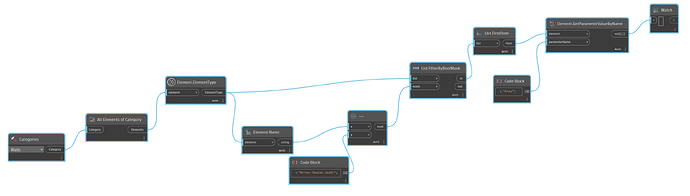

Hello everyone,
I need to get a specific area of a wall type, is there a node that I need here to get the proper input and get the parameter value?
Thank you again for helping a newbie. Cheers

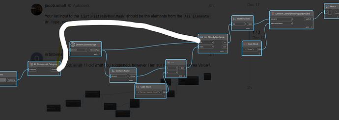

Your list input to the List.FilterByBoolMask should be the elements from the All Elements Of Type, not the names of the element types.

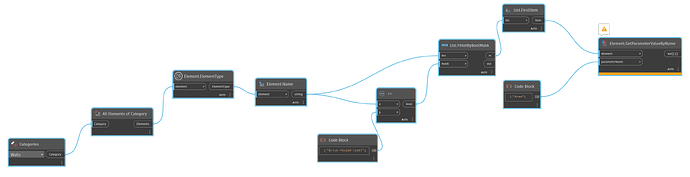

Thanks @jacob.small ! I did what you suggested, however I am still not getting the Area Value?
Any help is much appreciated. Cheers :slight_smile:
Guess @jacob.small mean as here…maybe :wink:
