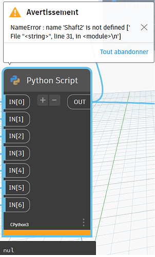

I’m trying to retrieve an element from a list by specifying its name, but I’m encountering the following error:
What is strange is that I can append the Names list with item names by typing the code Names.append(shaft.Name) , as shown in the output below. However, I cannot retrieve the specific item I’m looking for using the if statement ( see the 2nd image and the code below ) !?

hello
if shaft.Name == 'Shaft2': # shaft.Name is a string and 'Shaft2' is a string Shaft2 is a variable
cordially
christian.stan
@christian.stan
Oh, my bad!.. Your correction is logical. I forgot to put commas to be able to compare string to string!
Your correction solved my issue.
