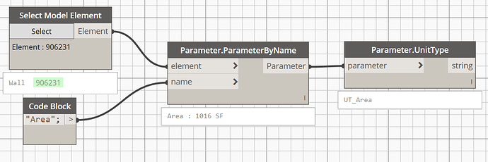

but how get the parameter from element ? (use the element and name of parameter) ?
That’s the most straight forward way. You can use Element.Parameter to get the element’s available parameters then filter by name.

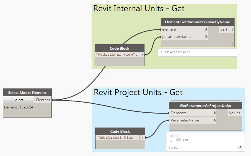

i want to get units from any parameters of elements and convert them from project units
MEPover package has a node called GetParameterAsProjectUnits which you can edit to see the Python code.
Is there a reason it has to be in Python? Clockwork and MEPover both have nodes that deal with project and internal units.

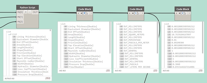

this my code
https://pastebin.com/w0fqpVeu
i am create convert-block as def function from every unit , but i m want to do it automatically - convert all units of all parameters from selected elements in projectunits in one way
So are you looking to get all parameters from an element or only specific parameters?
all parameters, thats may be : string, float, flow e.t.c …
for string and float DisplayUnitType is INVALID, for anotner units it is exist…
and for all units of parameters from selected elements i want to convert to project units…
This will give you the parameter object, parameter name, and unit type for all parameters of a given element. That might get you started.
dataEnteringNode = IN
element = IN[0]
names = []
units = []
params = element.Parameters
for param in params:
names.append(param.Name)
units.append(param.UnitType)
OUT = params,names,units
