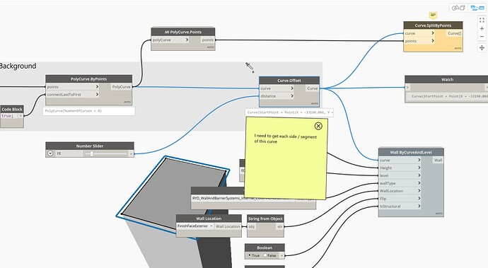

I’m looking for a way to get the segments / each side of the curve outputted from Curve.Offset node, however can’t figure out how to do so.
I tried using Polycurve.Curves, but that didn’t work as the output of Curve.Offset isn’t a Polycurve.
Does anyone have any suggestions on how to get the segments / each side of the curve?
