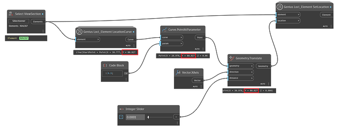

@Alban_de_Chasteigner
Wanna use your solution, but it always seems to move the Y direction?
Any idea why?
EDIT
Seems i was (partially) wrong. It does move in the X-Direction, but ALSO in the Y-Direction.
Also it only moves the right distance (in the X-Direction) when the value for the
Curve.PointAtParameter node is 0.
EDIT2

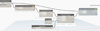

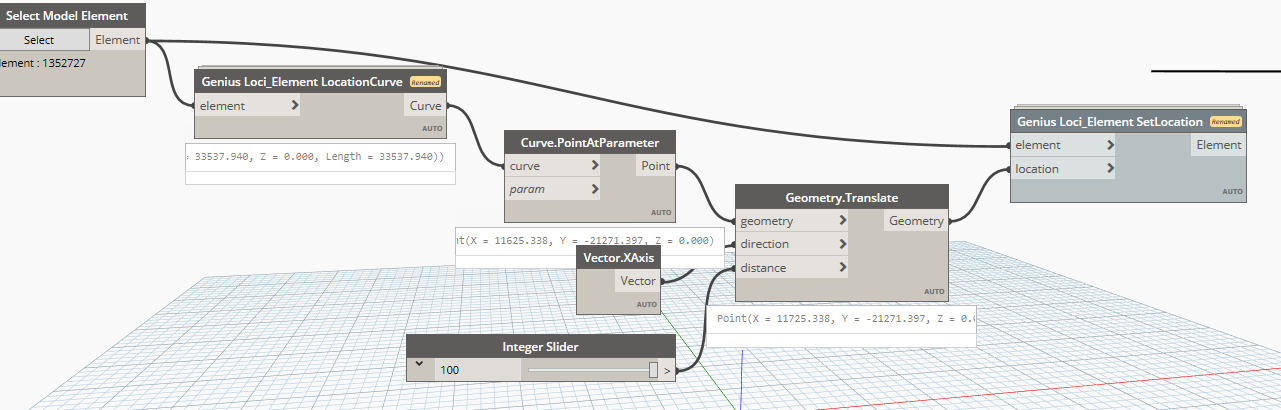

And a before and after picture.
It may depend on whether your section is parallel to the X axis.
If the section is parallel there is nothing abnormal.
Thanks for your answer. Your right.
When i try it on a Section in a completely blank Project it works.
When i try it on a Section which i drawn myself in my current Project it works.
When i try it on a Section set up by someone else it does not work. :thinking:
