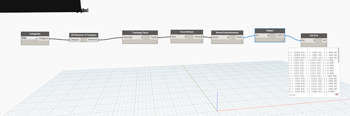

Well lets say i have two walls create a corner if i create a list for the edge’s points there’s four points with same coordinates , how to get it in a list.
Could you send a screenshot of your graph ?
If you need to sort your points by coordinates, you can use Point.Z and SortByKey. Try to use the search field with these keywords, or search for wall location curve optionally.
i want to get the same points in a separated list or remove all of it from the list , duplicate and similar remove keeps these points in the list.

not working did the same , the idea in these nodes its keeps one of the points what i want to get these points in a list alone then use list operation to remove them from the lest.
