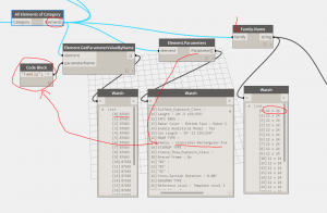

See attached image. I’m trying to get the family name of each element in a list. Not the Type Name, nor the Family Name: Type Name. Just the Family Name.
If I use Element.Parameters node, I can see that there is a Parameter called “Family” that contains exactly the info I need, which is “(Concrete)-Rectangular-Framing”. When I use Element.GetParameterValueByName, I get a number 87683. What??? And to Further confuse things, if I use Family.Name or FamilySymbol.Name, I get the Type Name “12 x 24” rather than the Family Name.
Any ideas? What is the intended use of Family.Name if it does not give the Family Name?

Thanks Dimitar.
That solves my problem I’m dealing with, but it does not explain the inconsistency between the Element.Parameters node finding a parameter called “Family”, but the Element.GetParameterByName node returning a 6 digit number for “Family” instead of the value that was found by Element.Parameters. Is that just some weird bug or is that 6 digit number actually the ID of the Family Type?
