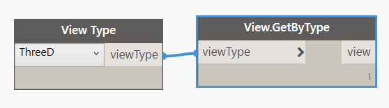

Hi All,
There is a easy way to get all views by type below.
Dynamo - Get All Views by Type
hope it is helpful!
