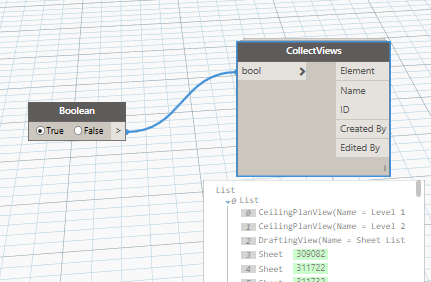

I’m having issues with this package. I’ve recently changed my workstation and the new one had nothing.
So now I have the Dynamo 1.2.1 instaled on Revit 2015, 2016,2017.
I have some scipts using the Get All Views script and now I’m not able to get it to be recognized.
Is the node still available?
the one I use still works but is a bit old.
Sometimes they change names of knots.
You are right Johannes, the older version does work.
Does anyone know which is the equivalent node for Get All Views for the newest version of archi-lab?
From Plissken:
Core:
Archi-lab, has a different set of nodes now, that perform the same operation. View.GetByType should help you collect views.
