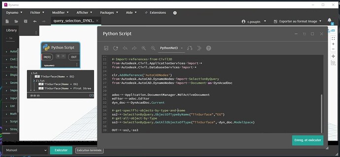

Hi @austin_perigee,
The All Objects of Type node is different than many others that you’re probably used to. It’s a class and cannot be “called” directly. You need the underlying function that it invokes when all the ports are wired up, which is not inspectable via Dynamo.
You’ll want to call the SelectionByQuery.GetAllObjectsOfType() method in your Python script.
Here is an example using SelectionByQuery.GetAllObjectsOfType, as mentioned @zachri.jensen

Thank You for providing the Python implementation! This works.
