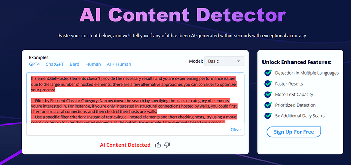

Try something here
Pure ChatGPT answer? :thinking:
assuming that this is confirmed, for information on the Autodesk French (maybe on all) forum this type of response automatically generated by AI without any proofreading effort is likely to be moderated
Yes Cyril, thats what i think as well :wink:
I ended using an approach similar to how you have explained above before being able to read your response. I am glad we are on the same page. Yes this worked out well and sped things up by 10x in some cases.
lol, this is not in the Revit API (as far as I know, I am okay with being wrong). It seems like you are making up API calls in a way that ChatGPT does.
