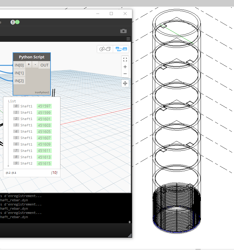

Hi All,

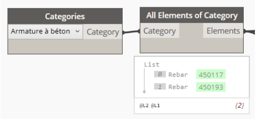

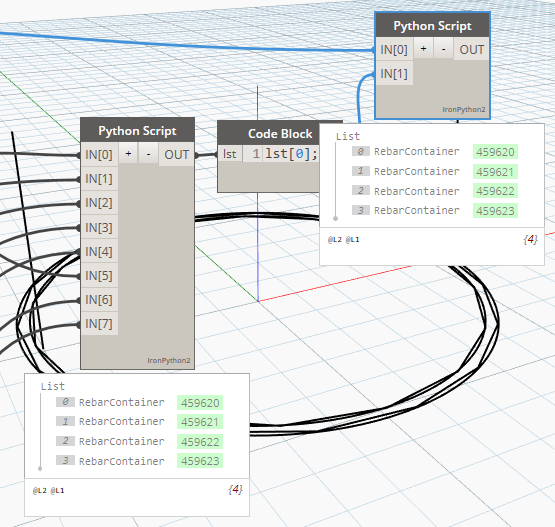

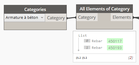

To get “All Elements of Category” in my rebar container using Revit API just as you would do in dynamo as shown below

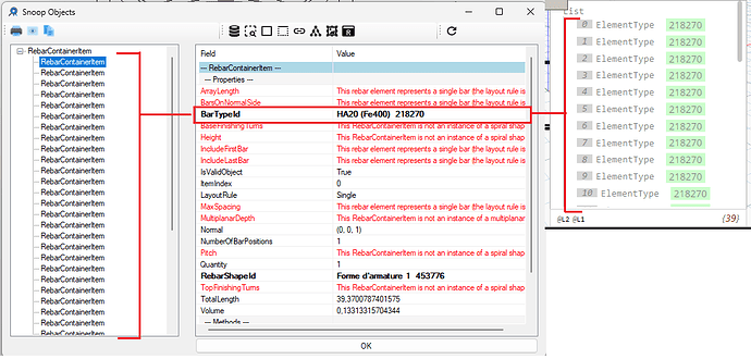

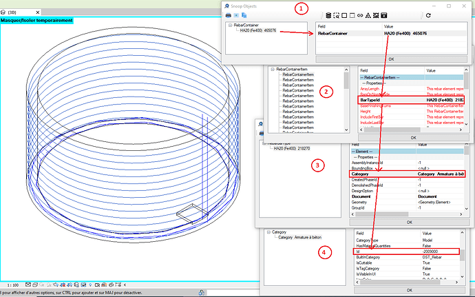

I used Revit Lookup and followed the steps indicated in the image below to extract necessary parameters and to be able to write my script, but I’m stuck on the last step which is getting All elements of Category
here is my graph and my script:

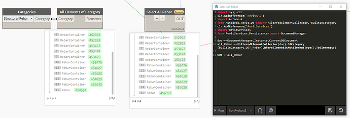

@jacob.small
I’m trying to get the BuiltInCategory OST_Rebar under Category Id as shown in the image below to get the final result as you would do in dynamo according to the 2nd image

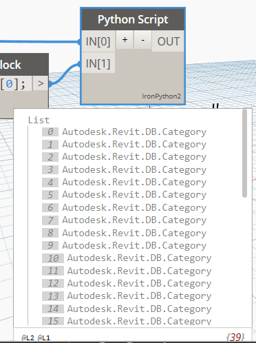

I’ve the same Element Type for each container Item inside the rebar container and I want to get All Elements Category for those rebars as I mentioned above

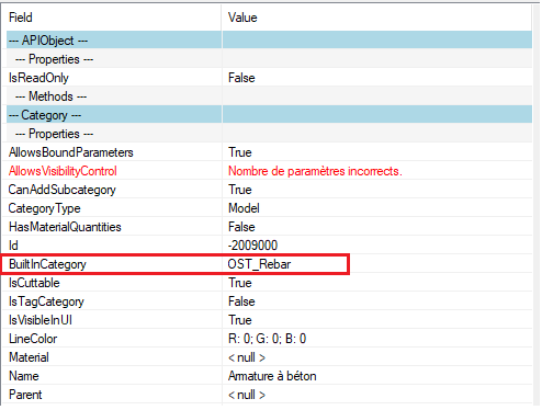

I used the code you linked, and I get Category but I can’t find the correct syntax to get the BuiltInCategory which is OST_Rebar??
rebars = []
for c in container:
    # get rebar type Id
    rebar_Id = c.BarTypeId
    # get rebar Elements
    rebar = doc.GetElement(rebar_Id)
    # get rebar category
    cat = rebar.Category
    rebars.append(cat)
OUT = rebars
Thanks.

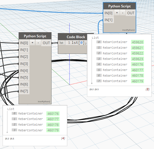

This has to do with how you are generating your rebar. To return the ‘Rebar’ type, you need to use a ‘per bar sketch’, which doesn’t scale well for hopefully obvious reasons.
Rebar containers allow you to populate a lot of rebar at once (as you likely know), with out defining each individual curve. If you use an All Elements Of Category node after pupulating your rebar containers with the Python code you’re using, you’ll see that it returns only rebar containers. If you manually draw a sketch rebar as well you’ll see it returns a rebar object.
The previous FilteredElementCollector element returns the same collection, with the same object types.

First of all, in your first snapshot, you are looking at the category of the BarType and not the category of the bar.
Second, RebarContainer is a special type of RebarCollection only available for creation via the API. The category of RebarContainer is OST_Rebar.
Thrid, each individual bar nested into the RebarContainer is a RebarContainerItem. And RebarContainerItem is not a subclass of Revit Element and does not have a categery (RevitAPI docs does not show Category as a property of this class). Therefore, FilteredElementCollector will not collect such items for you. RebarContainerItem Class
Your best bet is to collect and iterate over the RebarContainers after their creation to grab the RebarContainerItems.
