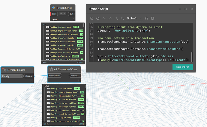

I believe you want this: OfClass Method
The modification of the Element Types dropdown was to make these in alignment. :slight_smile:

here is a list of all subclasses of Element class that you can access through this method.
Element Types has been renamed to Element Classes in latest Dynamo.
