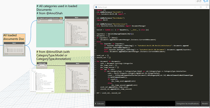

Get all categories used in a Document list
Hi @ruben.romero the last python made by @AmolShah works as expected on Revit 2021:
Cheers
@ruben.romero I’ve modified the code to ignore the documents that are failing:
x[0] will give you a list of document names that are causing the error.
Can you share one of the failing files if possible?

@paris Thank you for testing it out.
Hi @ruben.romero maybe try to verify if all your documents IN[0] are on Revit 2021
Cheers
they are all Revit 2021
It does not work, first time I read this warning type in Dynamo
Hi @ruben.romero can you share the RVT model 2021 and dyn file?
Cheers
not possible sorry
