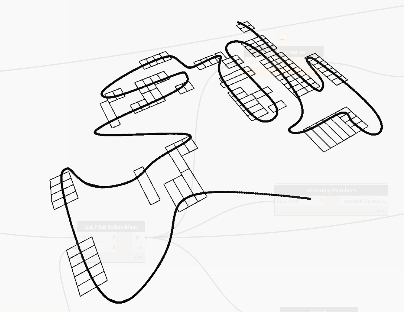

I have created a script, that renumbers areas, based on a a Spline and areas selection. The problem is that the script worked just fine untill yesterday, when I suddenly got a message about Geometry Scaling issue. After changing the Geometry Scaling, I recieved a warning from the Area.Boundaries node, saying: “points are most likely coincident”.
The strange thing is that from what I see, Dynamo has successfully recreated the boundaries, selected the Spline, etc. See image:
The other issue is that there was absolutely no problem with the same script, file, spline and even the areas, on Friday when I last used it. The only difference is that one of the areas was erased and we needed to re-run it. I tried changing the project units and the geometry scaling, but it does not seem to work (the file is currently in cm, I tried both m and mm). I really think it is a units - scaling related issue, but I still cannot figure it out. The projects is one of an extremely large scale, so this could be the problem. Attatched is the script.

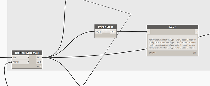

I tried accessing the area bounding box directly through the API, using the “Area.BoundingBox” property, but it seemed to return data in an uknown type in Dynamo (some kind of a “Reflected Indexer…”), see the pic:
Here is the simple code in Python:
You miss some reference to the Revit API. and the Boundingbox property needs a View in which it can calculate the Boundingbox

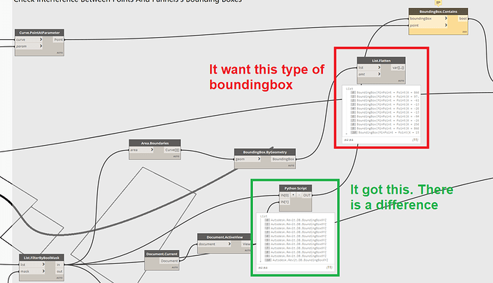

I finally got the time to test yourPython code, but it does not seem to work that way, now I get an error from the BoundingBox.Contains node, saying it expects an argument of type …Geometry.BoundingBox, but was called with System.Object
See image:
There is a difference between a Revit API Boundingbox and a Dynamo Boundingbox. You try a function which is made for a Dynamo boundingbox, but you try is with a Revit one. This causes the Error.
Can you not use the Element.BoundingBox node? Put the Area elements from the FilteredByBoolMask node in the Element.BoundingBox node. This should give you a Dynamo Boundingbox?
Is that doesn’t work we have to write a function for the Python node which parses a Revit Boundingbox to a Dynamo boundingbox
