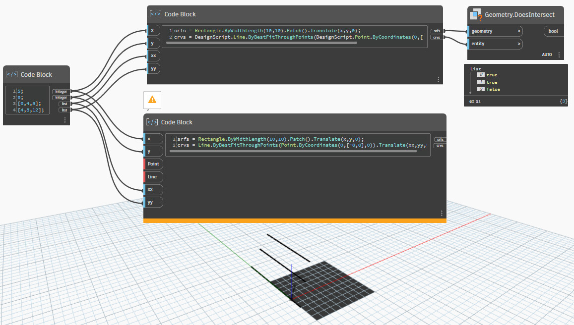

See if you can build standard Dynamo geometry to replicate. Something like this with a list of 4 doubles for each variable (x, y, xx, and yy) should suffice:
srfs = Rectangle.ByWidthLength(10,10).Patch().Translate(x,y,0);
crvs = Line.ByBestFitThoughPoints(Point.ByCoordinates(0,[-6,6],0)).Translate(xx,yy,0);
Wire those into the Geometry.DoesIntersect and you should get consistency. If not we’ve got a Dynamo bug to address.
If they are consistent then we’re into confirming geometry was the same in both Dynamo for Civil 3D builds and we’ll need a simplified dwg.
@jacob.small I copied your proposed code and adjusted it to this, because otherwise multiple definitions for Line and Point would otherwise be found.
srfs = Rectangle.ByWidthLength(10,10).Patch().Translate(x,y,0);Preformatted text
crvs = DesignScript.Line.ByBestFitThroughPoints(DesignScript.Point.ByCoordinates(0,[-6,6],0)).Translate(xx,yy,0);
I double-checked my scaling settings and these are the same - medium - on both 2026 and 2027.
Cross product lacing and check to make sure the results align with what you’d expect.
I tested this on 2027 with cross product lacing and with that basic code results are correct: we have one intersection with one surface and line.
