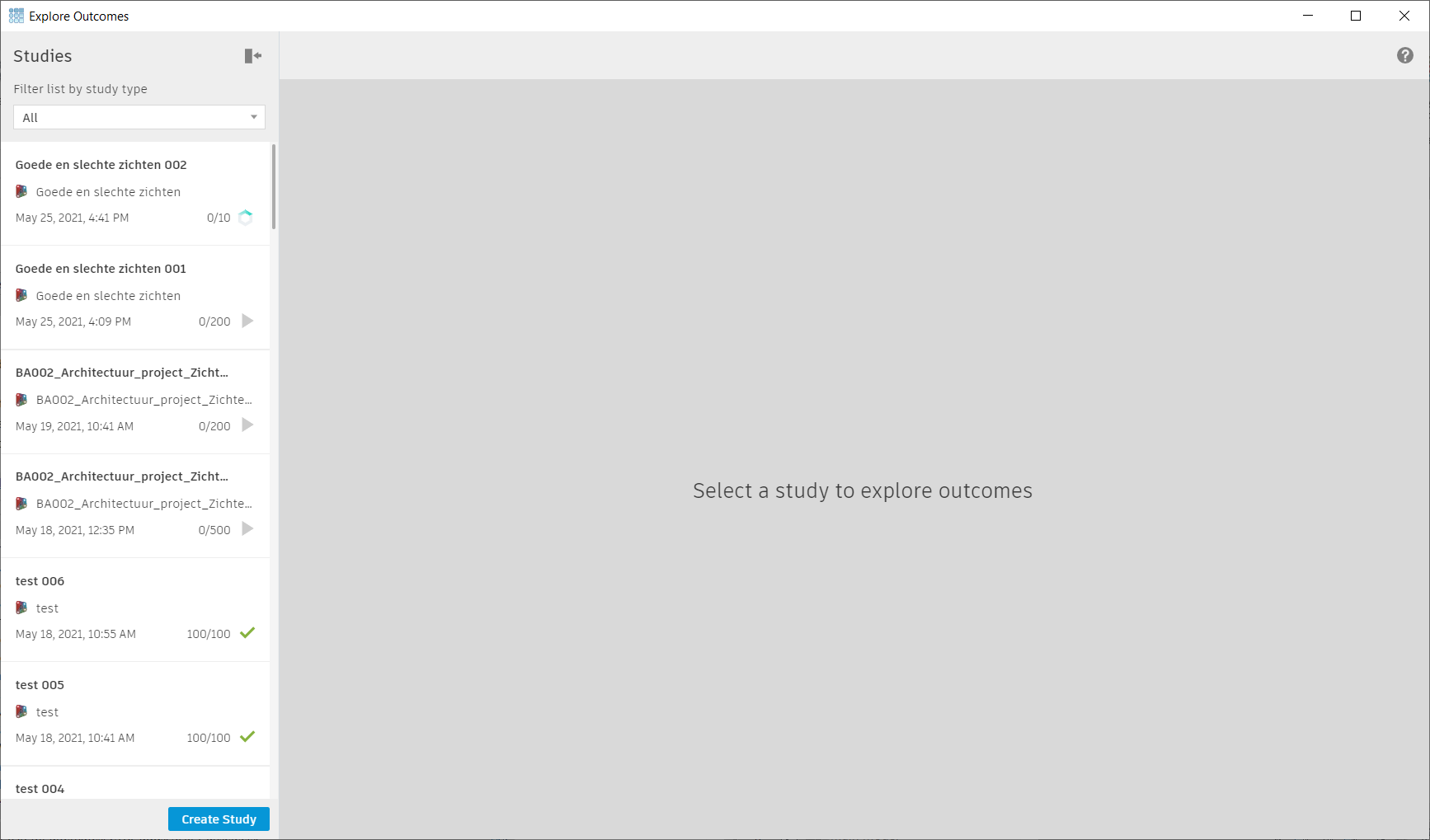

I’ve been trying to solve an issue I’m having with Generative Design. It’s simply stuck for some reason.
A script that used to take a few seconds has no results after many hours.

Pause that study as a first step. Then delete all the studies which haven’t finished/were delayed (looks like you have a few).

It isn’t possible to delete the studies in the Explore Studies window. The trashcan icon stays grey and can’t be clicked on. And to pause the study, I have to restart Revit first.

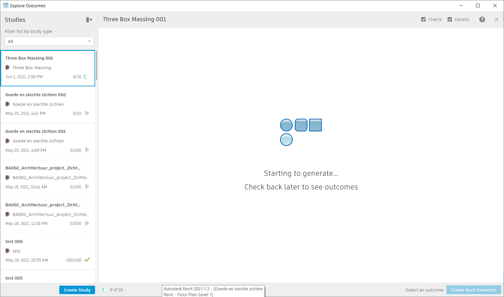

Does the 3 box massing sample file run?
I believe it doesn’t. I has been running for 20 minutes and is still on 0.
