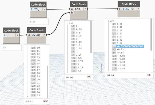

I got a question. why does dynamo sometime calculate wrong. look at this example
in thw last code block on index [7] the calculated number is wrong.
how can i prevent dynamo in this. because later on in one of my processes i have to use list.containsitem with a different list which has the correct number of -0.08 in it but the answer wil be false due to the wrong number.

Wouldn’t Rounding the Digits Solve the Problem?
I haven’t seen just plain wrong values like that before. Maybe it’s the older version your using?

Guess my eye don’t work, I missed the ‘8’ completely in that value and just seen ‘00000’.
I don’t think it’s wrong. It has to do with the way that double-precision floating point numbers work. This isn’t unique to Dynamo.
https://www.exploringbinary.com/why-0-point-1-does-not-exist-in-floating-point/
So basically, if you need precision out to the 16th decimal place, don’t use a double. Or just round it off :slight_smile:
@zachri.jensen is correct - this isn’t a Dynamo thing, but rather a dot net thing - C# Online Compiler | .NET Fiddle with double precision numbers :slight_smile:
I suggest you round the numbers like others have mentioned in this thread!
Thanks everybody.
i know understand why it’s happening.
for now i solved it for myself by using ‘object to string’ followed by ‘string to number’.
