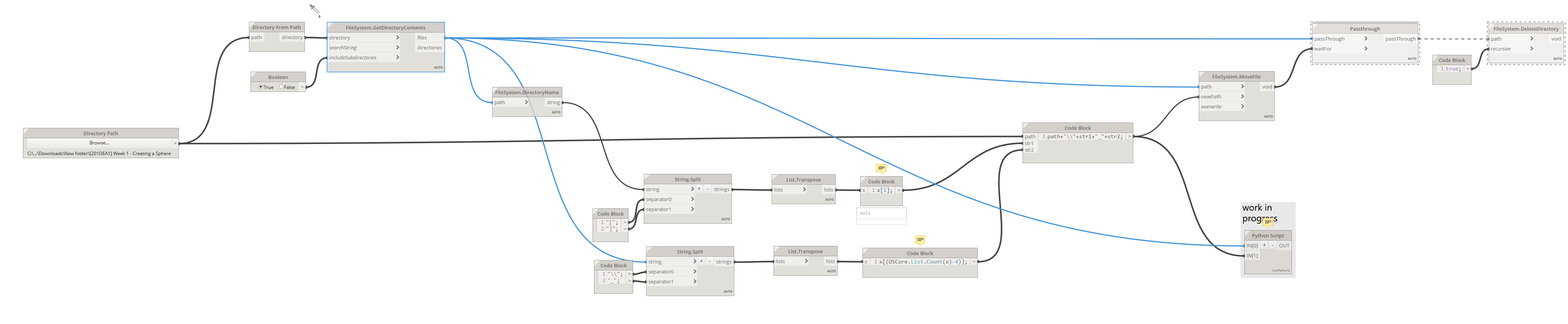

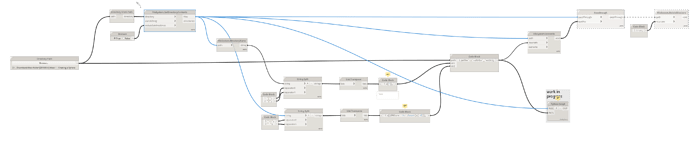

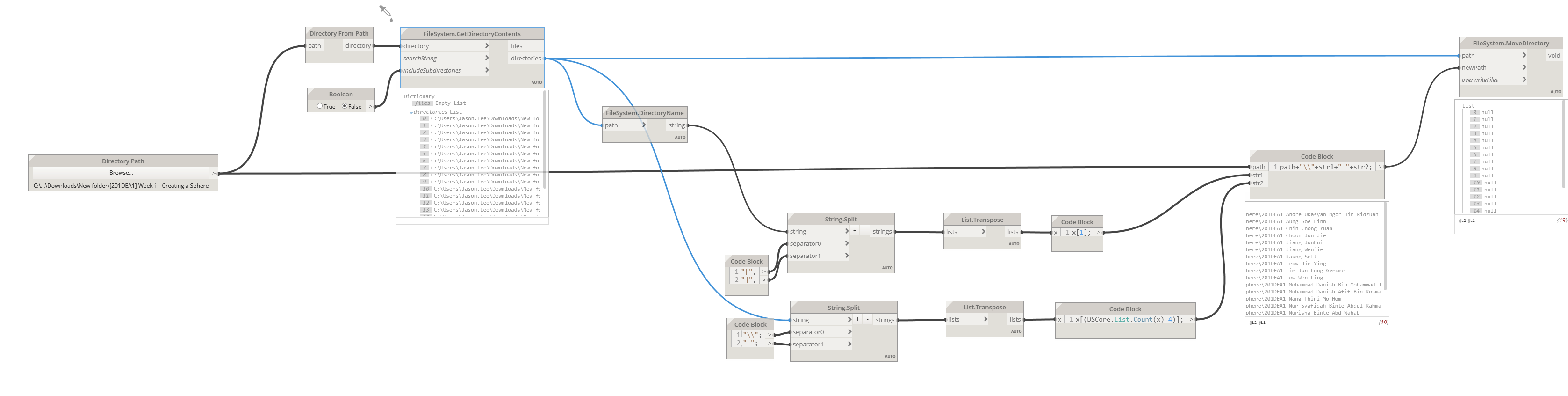

Hi @jasonlkw and welcome…think you can do it with OOTB nodes…
Screenshot 2021-11-01 200911
Hi Sovitek,
Oh hey! that actually worked! I thought I had to delete it with a passthrough linked to the solution.
Just out of curiosity though, is there a python solution out there?
The import os method does add a lot of possibilities too so I’d like to understand a bit more on that context.
Cheers mate :slight_smile:
