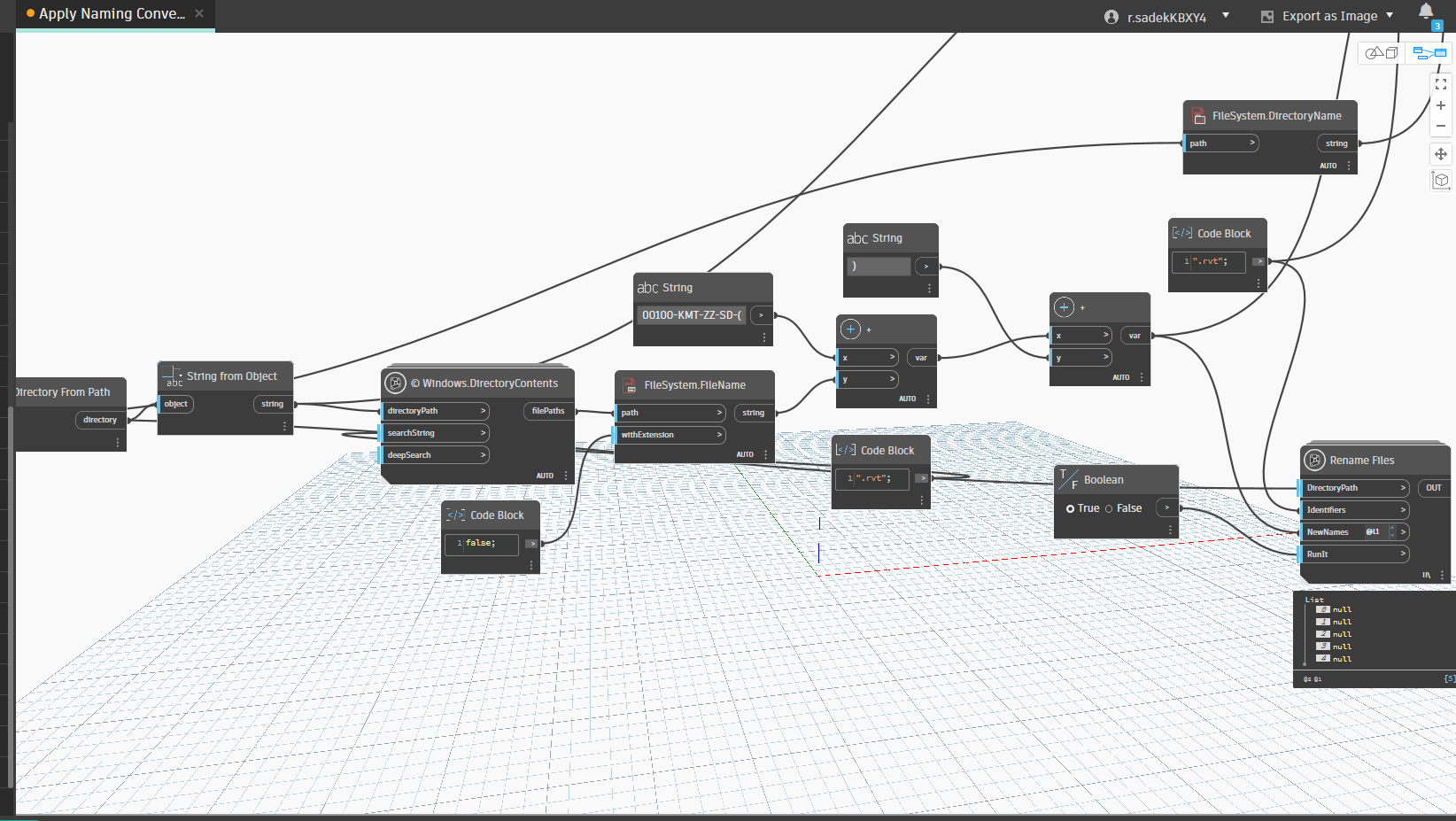

Hello
I am trying to use the “Rename Files” Node but was left with nulls
Dynamo 3.3
Is there an update to the custom node or something?
Hello
Dynamo 3.3

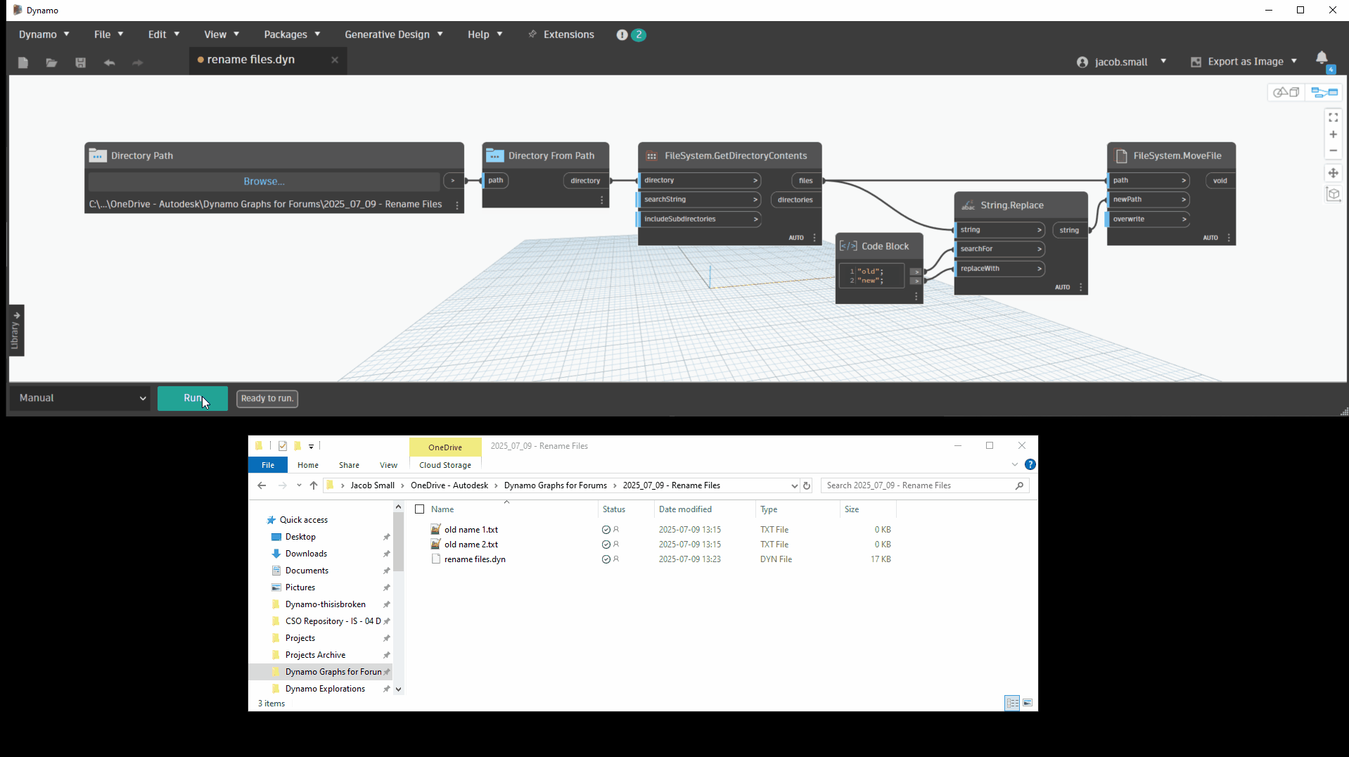

Best to try to use the out of the box tools which come with Dynamo for this, as they’ve been stable since Dynamo 1.3. You might have a reason to step away from them, but I don’t see one yet. The workflow likely looks something like this, but with your string replacement in place of the simple one I used.
This is the second time that you save me. I can’t thank you enough
Cheers, and thank you very much, dear
