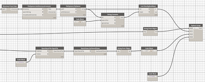

Hi John,
It is still possible to use the archilab code in a python node and it works perfectly.

Just have to watch your inputs.
Here is an example of code to rename exported viewpoints from NavisWorks.
Hope this helps.
sorry it still doesn’t work for me,is it because I don’t have IronPython 2.7 in “C:\Program Files (x86)”?
Anyway thanks for your reply.
Oh, it’s just because you are using a newer version of Dynamo.
I believe the dynamo team said they are no longer using IronPython and instead transitioning to CPython.
The only thing you need to do for this version to work is to install the DynamoIronPython2.7 Package and change the engine to IronPyton2 in the Python Script.
Hope this is it. :smiley:
