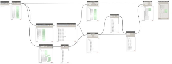

strange. it does not work in an actual project model file.

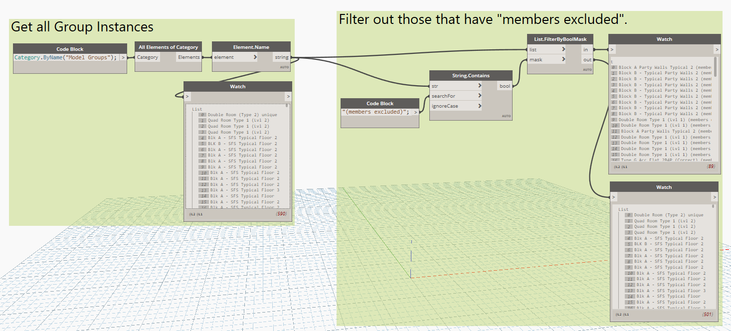

I used the above method previously, but I also noticed that it’s possible (maybe through an update in the API?) to read the name of groups which (now?) contains a suffix for those instances that have “members excluded”. We can use that to quickly filter a list of all group instances.
Just adding this for completeness and as an alternative solution as it can be done with OOTB nodes.
